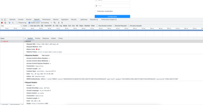

- Beiträge: 291
- Beiträge: 104
#10 Re: No IP/ Webcamstream in DOMIQ remote app Android
Hello support,
thank you for the screenshot. But if I call the camera website there is no section like "login.do" or any other section where to find the the mentioned "www.auth string" in the developer console.
Very strange...... I have no idea how to hand over your requested info.
Thanks for your help so far.
